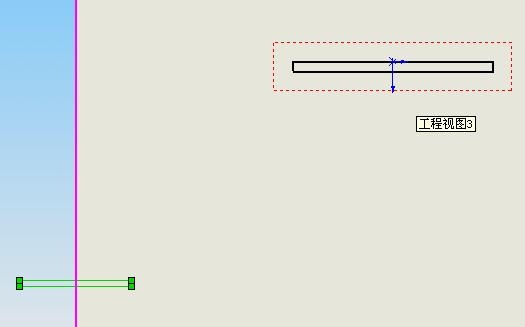

How to Drawing Rectang in view of GetOutline?
Use follow code, Drawing Rectangle is not in the target location.
Need Rectangle target location in GetOutline.

    SwDraw.SketchRectangle xx1, yy1, 0, xx2, yy2, 0, True
End Sub
