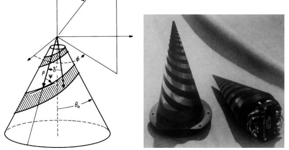

Hi, I'm a new comer to SW. Now I want to etch a spiral in a tapered tip just as the figure shows below. I know how to draw a single tapered helix but have no idea for this structure.
Are there any method on this subject? Your kind help is greatly appreciated.

Guanghao,
I had to think about this overnight. I have found a good solution:
1. Create a solid cone.
2. Create the helix using the surface sweep method.
3. Create offset distances for the beginning and end of the second spiral.
4. Use split line to turn the surface sweeps into faces on the solid body.
See my attached model for how to create this.

Thanks, Charles, your model enlight me
But this helix is just a surface line, not really etched into the cone with a definite thickness. I have no idea how to use the sweep method to creat a solid helix with varying width.
Any idea?

After creating the surface:
1. Select the face.
2. Choose Insert>Surface>Offset Surface.
     - Select an offset distance of 0.
3. Select the newly created surface body. Choose "Insert>Cut>Thicken"
This will cut that shape to a depth in the solid body.

Guanghao,
You can offset and thicken that surface in Charles' part as needed. This will allow you to make a solid out of the spiral. For the debossed part you will have to play with the ends to get them to come out correctly.
