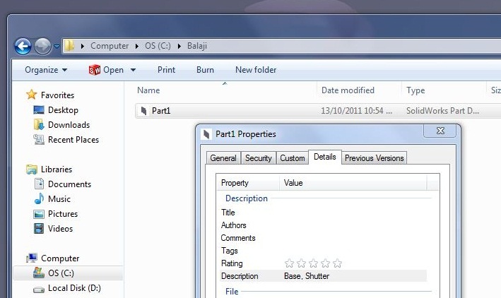

hi,
i can display part file in listbox. i used below code. but i want to display description details with open custom properties

how to read description details without open custom properties
