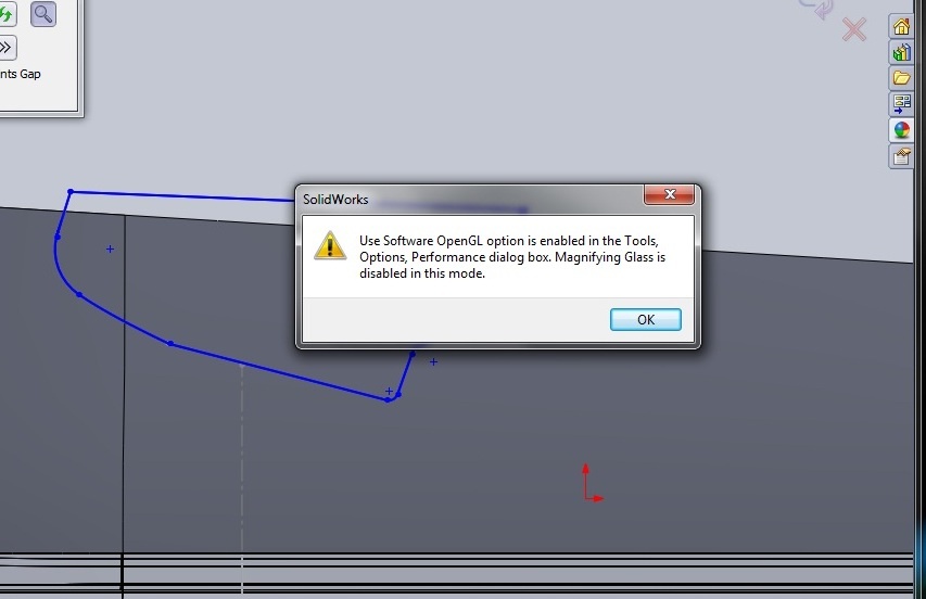

how to disable Use Software OpenGL??
I'm using Solidworks 2013 SP0 with Intel(R) Core(TM) i7 CPU 860 and running in Win7, how to uncheck this ''Use Software OpenGL''??

I have follow steps as shown in the pic below (obtained from this; http://warrantyvoidifremoved.com/posts/2012-08-27/greyed-out-use-software-opengl-solidworks), but still can't work. Anyone have any thought or idea to solve this?

You might try getting a graphics card that is supported by SolidWorks.
Fiddling with the registry to force this setting off may give you unpredictable performance with SolidWorks.

To enable or disable OpenGL, please follow the below tips or as shown in the attached picture :
1- >Tools > Options >System Options > Performance > Use software OpenGL.

As for mine, that option that you showed in the is grey and I can't untick the box. That is the problem.

Need ypur opinion, is ATI Radeon HD 3600 Series cannot support graphics for solidworks?

Check if it is on this list.
http://www.solidworks.com/sw/support/videocardtesting.html

Thank you Anna, it seems my cpu use lower version of Graphic Card...

Exit out of SW completely, then open it to a blank screen (don't open any parts or anything in SW). Go to options>performance>Select the box of Open GL.
Should work,

Shahrul, if you succeed in registry hacking your way into unchecking that Software OpengGL box, you're going to be back on the forums in two weeks asking why SolidWorks crashes when you create a sketch, or why it slows to a crawl when you switch windows, or why instead of your model, there's a supernova of triangular faces, or why your cursor disappears, or why your computer suddenly reboots in the middle of a modeling session-and the root cause is going to be the same as it is for this problem-your video adapter isn't suitable for SolidWorks.
You can buy an ATI FirePro V4900 for 127 USD or an nVidia Quadro 600 for 157 USD and get full display support for SolidWorks.  That's what you should do.
