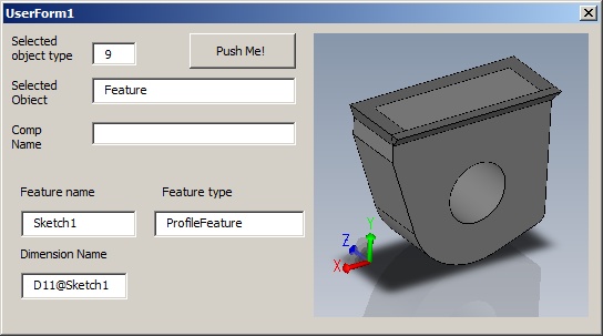

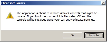

Just learned how to get a model -view to a userform via eDrawing API. This needs to load an ActiveX control and it gives a warning every time while running this macro or even editing it. Can I disable this and how?

I created a sample form and it seems to work OK on my machine. I am attaching it so you can try it on your machine just to see if it is perhaps a machine setting.

Thank you, Dan for your input. Got the same result (warning) with your sample.
Did some research (googling) and found a solution:
http://www.mrexcel.com/forum/showthread.php?t=212739
HKEY_CURRENT_USER\Software\Microsoft\VBA\
10) Right-click VBA, point to New, and then click Key.
11) Type Security, and then press ENTER to name the new subkey.
12) Right-click Security, point to New, and then click DWORD Value.
13) Type LoadControlsInForms, and then press ENTER to name the value.
14) Double-click LoadControlsInForms
15) In the Value data box, type 1, and then click OK.
16) Quit Registry Editor.
This did the trick and now works fine without any pop up -warnings!
