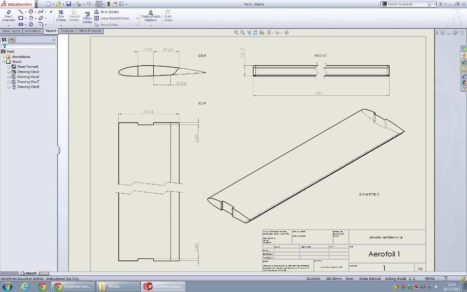

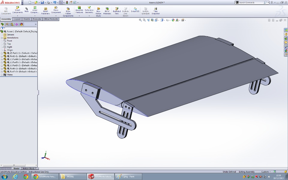

I've designed a model aerofoil (chord length 100mm) with variable angle flaps for use in a wind tunnel, the aerofoil is created from the NACA-2412 coordinates however, as I have split it up into 3 parts, the main part, the flap and an insert. I have used the spline tool to split it up.
I need to submit comprehensive technical drawings to a metals workshop, but I'm stuck on how to dimensionalize the curved parts? Should I attach a file with all the coordinates, and a set of large scale print-outs of the freeform shapes? I'll attach some pictures for reference, any advice on how to do these technical drawings would be hugely appreciated!

Matt,
Personally, I would check with the shop to see what they need. I would guess that they can machine the parts off of the solid models. If so, I would just put in dimensions that you can easily measure that will allow you to check the overall size and any critical dimensions with particularly tight tolerances.
Jerry S.
ML
ML 2014-01-07
In addition to "critical dimensions" (I don't really like that term because any dimension for any feature is critical - otherwise the feature wouldn't be needed), the method of growing using is to declare the model as basic and apply a profile all over symbol to all surfaces.  I talked this a long time ago here: http://www.fcsuper.com/swblog/?p=213
