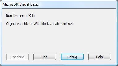

UPDATE:
I think I have found a method for which I could use isPlane, but I'm not sure why one part of this isn't working.  Here is what I have come up with:
Code Sample
'Declarations
Dim isThisAPlane As Boolean
Dim WorkFace As Face2
Dim WorkSurface As Surface
Dim SelMgr As SldWorks.SelectionMgr
'Determine if the selected face is 2D
isThisAPlane = False  'initalize variable to false
WorkFace = SelMgr.GetSelectedObjectsFace(1, 0)  'obtain the face from what is selected
WorkSurface = WorkFace.GetSurface               'obtain the surface from the face
isThisAPlane = WorkSurface.IsPlane              'check to see if surface is 2D
The problem I'm having (aside from not understanding everything that's going on... I'm new at this) is that my line to get the face from what I have selected:
WorkFace = SelMgr.GetSelectedObjectsFace(1,0) 'gets the face from the selection
generates the following error when I run the macro:
What is it that I'm doing wrong?
