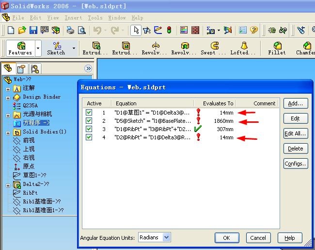

How to delete the equation at the specified index
Hope delete select 1,2,4 Item Equation
record Macro ,the code is

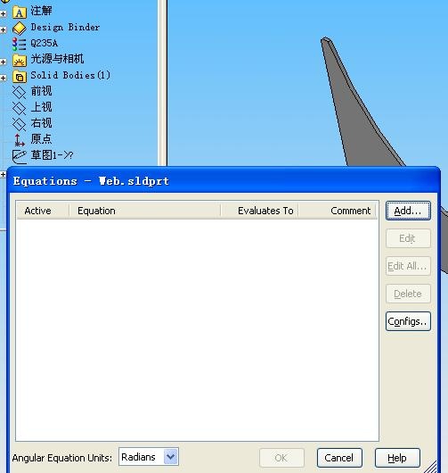

  Set Part = swApp.ActiveDoc
  Set SelMgr = Part.SelectionManager
  boolstatus = Part.Extension.SelectByID2("Equations", "EQNFOLDER", 0, 0, 0, False, 0, Nothing, 0)
  Part.DeleteAllRelations
End Sub
The Code result is
