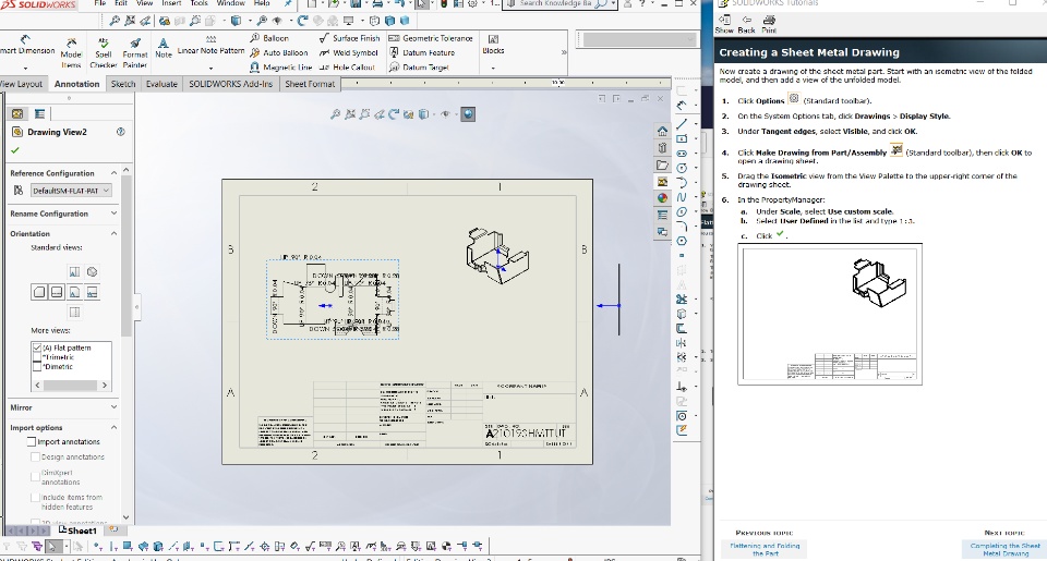

How to Delete the Drawing portion only.
I'm in the drawing portion of this tutorial. The instruction are not quite correct. I've gotten a page size that is not what I would like. I'd like to delete this portion of the tutorial and then start it again.
How can I back up to before the drawing portion ?

But if I follow the tutorial instructions, it keeps opening an "A" sheet with the view pallet. But if I go to the File menu and chose  new drawing file and sheet format, then I don't get the view pallet.
Is there a work around from inside the tutorial where I can change the A sheet to a B sheet before I chose any parts from the pallet ?

If it's only sheet size that you need to switch, you can always reload the sheet with the proper sheet format rather then redo the entire drawing. Here's an article with a few screenshots that explain how to do it, of course in your case it only applies to one page but the principle is still the same.
SOLIDWORKS Sheet Format modification for multiple sheets
