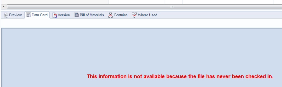

So I've seen a similar post on this, but it wasn't quite the same. I am trying to delete a folder, but it has not really a phantom file, because I can see it, (logged as admin) but the file thinks it has been deleted already.
I have checked and rechecked all workflows, and there aren't any states that don't have permissions assigned to them, or states that are not connected to the rest of the workflow. I can't right click on the file to do anything to it since epdm claims it has never been checked in.
Any ideas? Thanks!

Logged in as Admin, you should be able to just delete the file. Right-clicking will work with Admin-user. You just need to accept the warnings that the file is checked out by someone else.
If it's playing tough, you can try deleting it from a Command Prompt window, you need to know a little bit about old DOS commands to do this. This however only works if the file is actually on YOUR computer. It may reside on another computer. Check the "Checked out in" column in Windows Explorer.

I am unable to right click on the file, as I stated in the original post. Even logged in as the admin user, I am unable to do anything with the file.
Where might I learn the necessary DOS commands?

I miss interpreted what you meant. Thanks, that worked!
