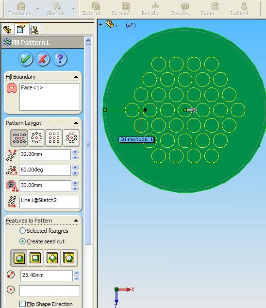

How to define feature typename of Fill Pattern?
Private Sub ll()
   Dim SwApp As SldWorks.SldWorks, SwModel As ModelDoc2
      Set SwApp = Application.SldWorks
      Set SwModel = SwApp.ActiveDoc
   Dim SwFeat As Feature
      Set SwFeat = SwModel.FirstFeature
      Do While Not SwFeat Is Nothing
         Debug.Print SwFeat.Name, "→Feature GettypeName→", SwFeat.GetTypeName
         Set SwFeat = SwFeat.GetNextFeature
      Loop
End Sub
Result is → Fill Pattern1 →Feature GettypeName→     APattern
Question, How to define p typename???
Dim p As LocalLinearPatternFeatureData  ' As LocalCircularPatternFeatureData  'FlatPatternFeatureData
      Set p = SwSelMgr.GetSelectedObject5(1)
