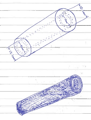

How to cut out hollow cylinder shape
I am attempting to cut out a hollow cylinder shape from within a solid cylinder.  A key requirement is that the two ends of the cut-out shape must have different diameters.  I have attached a drawing to show what I am aiming for.  The dashed area shows the shape I would like to cut out.  The bottom drawing shows the solid (blue) area and the cut-out (white) area.

Welcome to the forum.  Create the solid cylinder first, then sketch a circle of the desired diameter on each end.  Create a lofted cut using these two sketches.

Hi, thanks for the reply Glenn.  I have tried your suggestion and I have had no success.  I created the required circles as shown in the previously attached image, and when I select the sketches and try to create the lofted cut, I get the following message:
"Select a continuous group of entities."

Create the part using a revolve. One feature and one sketch to accomplish the body and the bore.

You may have had the section for guide curves active when you were selecting the profile sketches to get that error message.  Lofts also work better sometimes with a guide curve.  See enclosed.  By the way, the recommendation to do it in one step with a revolve is good advice, assuming that the hole is centered on the cylinder.  If it isn't, as in my example, then you will need to use the lofted cut.

you can do an off-center cut with a revolve also - see attached. with a revolved cut, you won't have issues with the shape "twisting" in the loft.

I've now managed to create the shape I needed.  Using revolved cut was the right method.  Thank you for your help.
