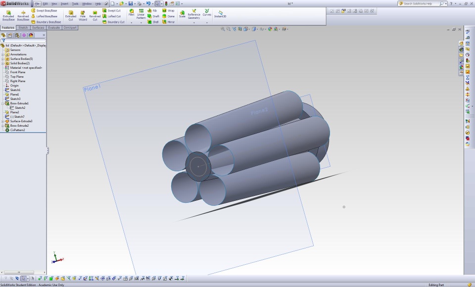

Hi,
Can anybody tell me how can I cut this extruded cylinder with this surfaces with which I made the circular pattern.
I wish to achieve something like on the needle cap has that feature from the syringe, is like a boolean, so if i will cut it will not to be empty inside but will take the shape of the cylinders.
Thanks in advance

Use Cut With Surface.  I don't think it's on any Menu so you have to add it using Customise.  Icon to search for attached...

You can also use the Split tool, which isn't a standard menu feature either. The surfaces will have to fully intersect the solid for Split to work. With the relatively simple geometry in your image it's probably just as simple to do a extrude-cut , sweep-cut or loft-cut, then doing a circular pattern of that.

You might want to cut with surface for one cylinder and pattern the cut itself.

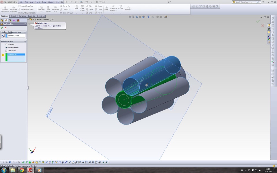

I know but is weird because I am doing something wrong but can't figure out what. Please see my attachment.
I had selected the surface which i want to cut and the body with which i want to cut, I cannot select them all but anyway appears this error.

From this scren shot it appears you have already cut the cylinder with the selected surface, just hide that surface and you will see.
Also, Alin makes a good suggestion as well.  Or you will have to select each surface individually

Aaaaa! Yes, perfect sorry. Yes thank you got it know. The easiest way was indeed to make the cut and then to pattern it.

The end of the tubular surfaces will not be flush or parallel to the flange face so you are probably creating zero thicknesses or slivers using that method. There are other methods to create what you want.
Can you upload the actual file for testing?
Which version of SW are you using?

I managed thank you, I was just not selected the objects properly. (beginner )  I cut it then pattern that cut and worked.
