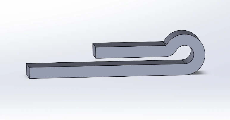

Hi. I am trying to model this type of part in solidworks using sheetmetal tools. I was able to create the circular portion using the hem tool, but I can't add an edge bend less than 90 degrees to get the return portion that is parallel to the long portion. I adjusted the hem to about 220 degrees, but can't seem to get that sharp return bend.
Can anyone advise how I can do this? I created this sample as a solid model, but I want to use sheetmetal due to other bends, and the ability to unfold the final model and get the proper lengths of everything.
Material is 1/8 x .75 flat steel. Radius is .125in.

right now this is where I'm stuck. I tried adding a base flange to end of hem, but it opens a sketch. Am I supposed to sketch the desired shape? Will it become part of the sheet metal shape and unfold properly?

I did sketch out the shape and boss extrude, but the part remained when I unfolded. If I tried to merge, the extrude failed.

This is with an edge flange, but I can't go under 90 degrees

OK. I finally was able to create a sketch and extrude boss, and merge the result. It does unfold flat. Guess I'm all set, thank you!

draw this as an open profile and then extrude a base flange to your width.
