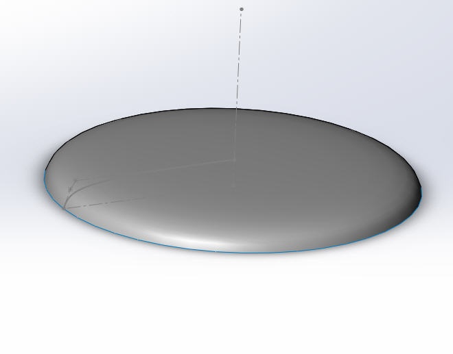

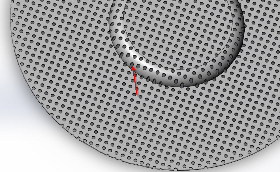

how to create a trough all cut extrude normal to a curved surface using pattern ?
I am currently trying to model a kind of grill net which is shaped with a curve surface defined by a spline which is revolved around an axis using surface.
This one have holes in a pattern way. Those holes can be done from an extrude features but I need those extrude to be perpendicular/normal to the surface. So far I success to make some holes but they don't follow the curvature of the shape on the curved part.
Any how I can do this ?

If you create it as a surface model, add the holes, then "Thicken" the surface, the holes on the curved faces will be normal/perpendicular, but you will run into issues if they cross the edge -

, I'm not sure if you can use this same approach but I tried what your asking for using the "Wrap" feature and it seems to do what you want ...
Holes on a flat plane (Not normal to the surface)
Same sketch used, but used the "Wrap" feature instead with a Deboss to extrude through the material ... (Holes end up normal to the surface)
