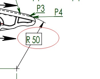

Basic dimensions, when you are using the ASME Y14.5M standard, signify that this dimension is a representation of the theoretical exact number. This "dimension" has 0 tolerance. The "feature" that is being dimensioned however does have a tolerance, and the basic on the dimension is telling you that the tolerance is coming from a Feature Control Frame somewhere on the print. The shape and size of the tolerance zone for this feature is then determined by what is in the feature control frame.
Example:
(this picture is just an example).
In the above picture, the dimension should be coming from one of the datum points signified in the Feature control frame under the hole dimension.
The picture shows that the "theoretical exact" hole is 0.776" from the datum. The tolerance for this hole is then taken from the feature control frame. In this case, the position tolerance zone shape for the hole is a cylinder that has the same length as the hole depth and has a diameter of .002", centered on the theoretical exact centerline of the hole. This means that, when the actual hole is manufactured, the centerline must fall inside the zone created by that cylinder. There is no tolerance on the 0.776 dimension at all.
If the feature control frame were NOT under the hole dimension, then applying basic to the dimension would be incorrect and you would then add a tolerance to the dimension, whether this be from the title block, notes or directly onto the dimension. If you have a hole that has a horizontal and vertical dimension added to it that has a tolerance of +/-.001 to both the horizontal and vertical dimensions, then this would be similar, but not the same as the above referenced feature control frame. The reason that it is not the same is that, in the case with the vertical and horizontal dimensions, the tolerance zone is now in the shape of a square. And you can see that if the hole, when manufactured, were to be made a the limits of those dimensions, then the hole would fall outside the zone that is specified by the feature control frame.

Is there any forum where I can post my ask about the meaning of tolerance sign?

You can post is here and we can try and help you. Just make sure that you specify that it isn't a specific Solidworks question (I have done that before).
Are you just trying to box the dimension? Then any of these should work for you:
OR
Shows up like this when the radius is inside the arc:
Specifically with ANSI set to the dimension standard in options.
Thank you, @Dan Pihlaja, I did it. Do you know the meaning of that square?
It is called a basic dimension.
Basic dimension - Wikipedia
Please mark 's reply as Correct (see #3 at ).
