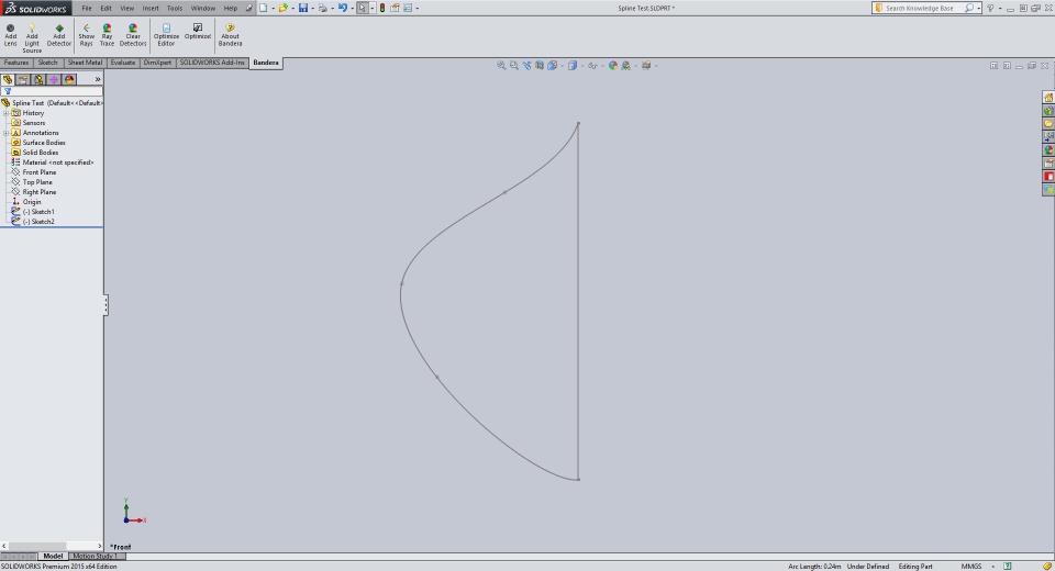

Here is an example of spline I create. Line is just a center line.
CreateRevolutionSurface always returns null no matter what point and axis I take. But it works fine if I use for example line, arc or ellipse.
