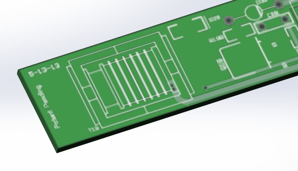

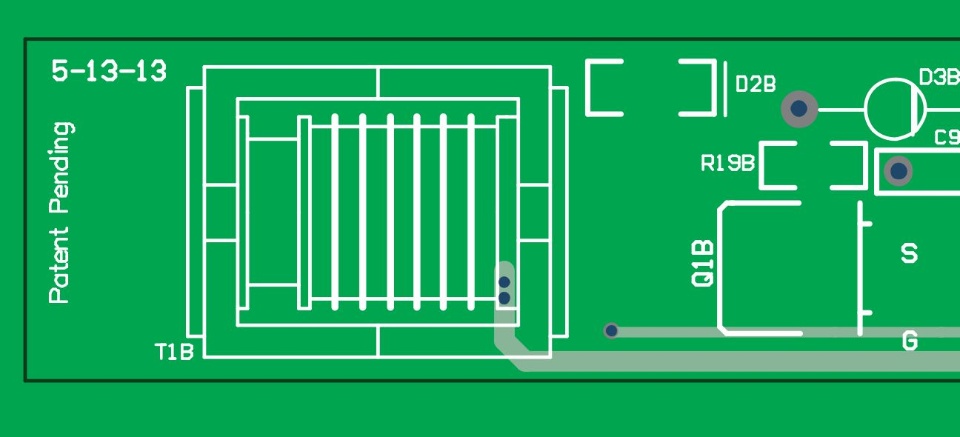

I have tried to create a decal 19mm wide x 400mm long for an electronic board, I exported this file to bmp, tif, jpg, png when exported the picture looks blurry and the letter are distorted, is there a way to create a good quality custom decal that allow me to read the letters. I notice if I divided the drawing in 3 parts and import each decal I can get a better image but still the quality no good.
Last picture is the decal in solid works numbers and letters are not clear

Hi Brian
thank you for your prompt answer, I tried to load the file here but it didn't allow me because it was too large, however I have another picture with the same problem the real dimensions are 553mm x 13mm, I exported this picture with photopaint X5 using a 300dpi resolution and still having the same problem not sure what I'm doing wrong... I noticed exporting smaller boards if the sizes are less than 90mmX13mm the quality of the picture is good. I can e-mail you with the original file also. But most important to me is to be able to know how to do it export the file since I have several boards to build.

I use the 300 dpi with another file and not sure why still blurry
The next picture is a print screen of the original file, you can tell the loss of quality in solidworks

Eduardo,
I get the same blurring as you do when I apply your decal as you can see below.
It seems that SolidWorks seems to struggle with decals of these large proportions but I did find although it looks blurry it does render OK in PhotoView 360 as you can see below.
The only way I could get your decal to look any good in SolidWorks was to crop it lengthways by about 50% & then it looked reasonable as below, but of course only half the board has a decal on it as you mentioned.
Maybe someone else knows of limitations in the decal system & a way around it. Perhaps you should submit a bug report to your VAR & see if they can help.
