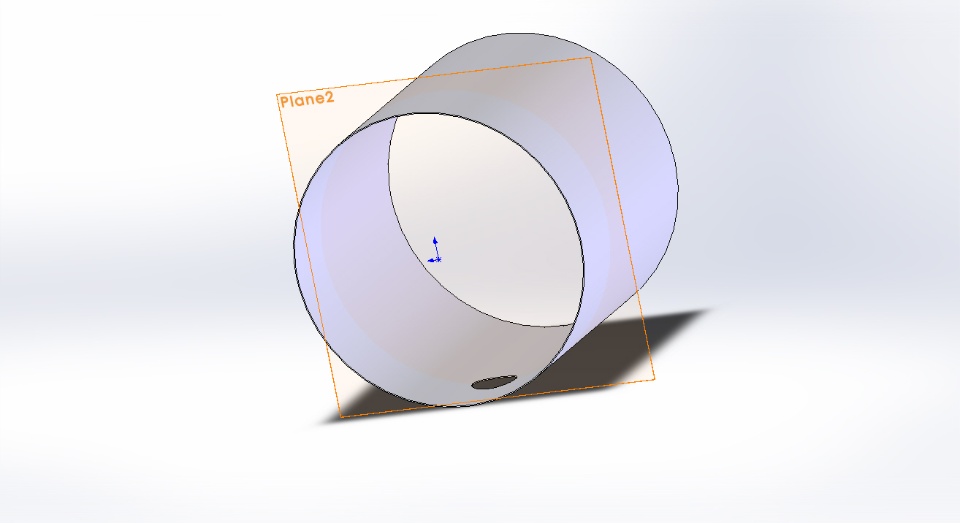

Hello Forum,
I am using SW 2014. I am trying to create a flat surface across a hole that I have "Cut" through a thin walled cylinder. It is for a bung connector part that is flat and will be soldered to the flat area of the "hole" in the cylinder wall  when I build this part. Its easy to do for real, in sheet metal, but seems very difficult in SW. I realize the new surface may have to be curved, around its edges to make the transition between flat and the curve of the tube, but I do not know how to model this?

ÖT 2021-04-09 Best Answer
Is that what you're talking about?
comment imagecomment imagecomment imagecomment imagecomment imagecomment image

DP
DP 2021-04-09
2 questions:
1) where do you want the surface located, radially?
4 different possible locations of the same flat surface:
2)  What is the diameter of the flat area?
     If it is the same diameter as the hole, then your transition area will be bigger than the hole.  If the hole represents the transition area AND the flat area, then your flat area diameter will be smaller.
JG
JG 2021-04-09
Yes this is much closer to what I am trying to achieve. Can you share how you did this please? J.Gaertner

JG
JG 2021-04-09
No, I am trying to make a flat surface across the hole. It would kind of be like a very thin Boss on a casting. This cylinder is only 0.024" thick steel. If I were making the part in my shop I would only have to place a metal Dolley on the inside of the cylinder and strike the outside with a round flat faced hammer to make a flat spot on the cylinder surface. But thanks! Here you can see I have modified my cylinder profile to have a flat. But what I really want is to JUST have the flat area, where the blue sketched circle is. Not a flat area on the entire profile.
This is "Closer" to what I want but this is just a very shallow boss draw with 2 fillets on a very precisely located plane, offset from the Top plane.
