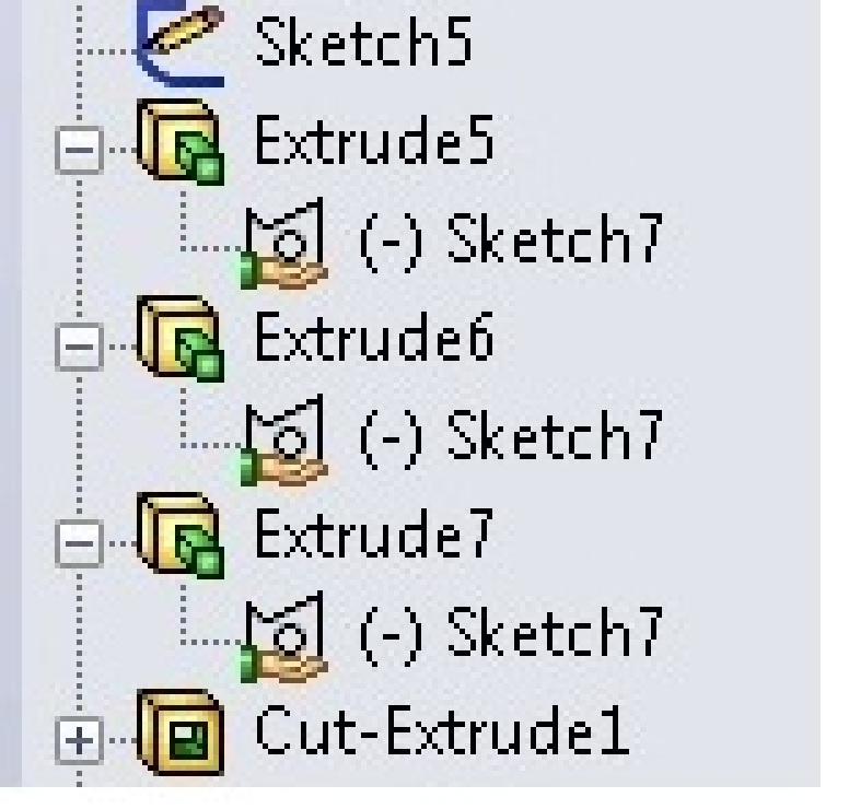

I have recently seen a solidworks file that its parts had been created using different entities of a single sketch. The entities of this sketch crossed each other and the sketch has an icon similar to file sharing icon in windows ( a hand with a sketch , as shown in the attached file). Is there anyone who knows how I can creat this kind of sketches. It would help me a lot if someone help me with this. Thanks

Nothing different in the sketching environment. When you create your Boss-Extrudes, expand the "Selected Contours" section of the property manager. You can now select individual clused sections to extrude.

I really appreciate your time Wayne, I got it,  Thank you for your help

To add a bit to this, if you go to selected contours at the bottom of the extrude command, you can select parts of the sketch to extrude or cut.

To add to already added,
Don't forget copy/ paste sketch and derive sketch and also the SelectionManager for certain features in which you can use or reuse by selecting individual entities of a sketch.
