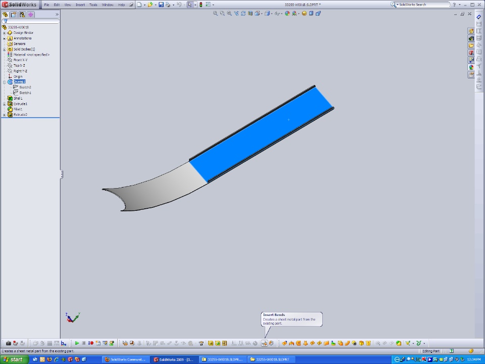

Hello everybody.
Please help me to convert this part to sheet metal.
Thanks.
Kelvin,
I tried that before, it didn't work.
The Rebuiltd Errors warning comes on :" This Process-bend feature failed due to failure of Flatten-Bends"
What did you have set for bend radii? Did you have an Auto Relief set?
Works for me with relief set to tear and radii set to .030 (These were just the defaults I had set) and my bend allowance was K-Factor 0.5
Thank you guys!
Works now.
Kelvin,
Thank you guys!
Works now.
