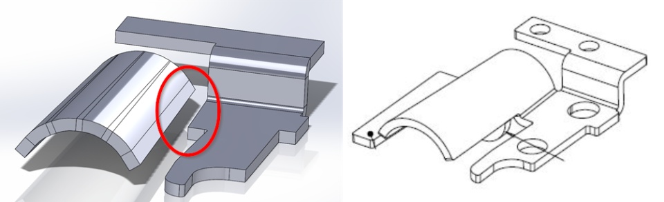

I am recreating an already existing sheet metal part in Solidworks.
It started very easy with the flat surfaces but the part has a lofted bent that I have to connect.
Which feature do I need to use?
I am not that familiar with sheet metal drawings so if my method is wrong you can correct me anytime.

I would do that as a conic feature rather than lofted bend. (Or is it really cylindrical rather than conic?)

It does appear conic in the OP image as the form lines aren't running parallel to the round's edges.
I'd start with the cone and build out from there.
I start with a revolved thin and convert to sheet metal using Insert Bends:
I add edge flanges to both sides and edit each sketch for the shorter (20mm) length:
The second sketch length is equated to the first one in equations:
(All other equations are for my inch to your mm.)
The rest is regular sheet metal build out and from your OP, it looks like you have this in hand.
SW2018 attached.
I hope this helps.
Kevin
EDIT: Forgot to mention (and it's not in the model) to use equations to "level" the first edge flange angle (relative to your 136° conic angle) and then equate the second edge angle to the first.

The shape is conic. I can try conic feature.
The only demand is that i can flatten the whole part at the end.
