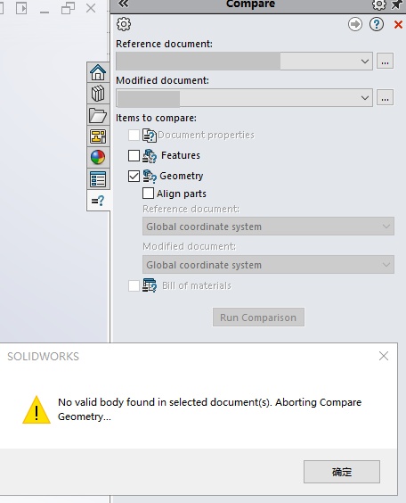

I tried, but failed. The error message shows:"No valid body found in selected document(s). Aborting Compare Geometry..."
I need compare the difference of two STL files, the method I use now is compare them in assembly files with base point alignment.

STL is mesh, points and lines, no body to compare.
You can try ScanTo3D and convert it to surface and solid first.
Or find software that can compare mesh.

@JL ​​​​​​ I would use the new body compare tool. ( see:  http://help.solidworks.com/2021/english/solidworks/sldworks/c_body_compare.htm  or on youtube: https://youtu.be/06B6YcoNuoI ). Essentially what I would do is open each STL as a part file, save the parts then create an assembly and locate the two STL files on top of each other. Body compare will show the differences between the two STL files. Note that we have a lot of great and powerful functionality in SOLIDWORKS for working with mesh files. Please see the following videos for more information:
