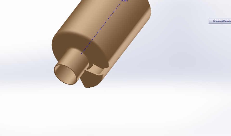

Hi,
I am using SW 2012X64 EDITION SP2.0
I want to close both open areas and make it rounded and smooth
any ideas??
here is a pic and the model is attached
SolidworksParts And Features
Answers 5
SF
SF 2012-02-09 Best Answer
This is a pic of how should look like
comment imagecomment image

Jonathan,
I don't have 2012 so I can't open your file, but it seems to me that between the offset surface,
trim surface and the other surface tools you should be able to make this happen.

Scott,
Thanks in advance,
I have used SW just for 6 months, so I am a beginner user,
I will practice the tools that you mentioned to make it happen.
SM
SM 2012-02-09
That's fine.  We all have to start some where.  The best tutorial I can suggest would be to go to youtube
and search for surfacing type videos.
Also here is another thread that references other surfacing learning tools that might help you.
https://forum.solidworks.com/thread/44170
SF
SF 2012-02-09
After using,
2- BOSS-EXTRUDE
1- CUT EXTRUDE
1- CUT REVOLVE
3-FILLETS AND
1 MIRROR
This is what I got so far,
I forget to mention that I am trying to model a hand-made fiberglass tank.
So the shape it is not uniform.
I couldn't use any surface, I really need to get focus on it,
