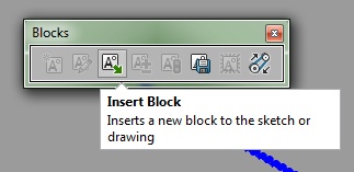

How to clear the "Open Blocks" list in Insert Block function??
How do I clear the "Open Blocks" list in the Insert Block function?

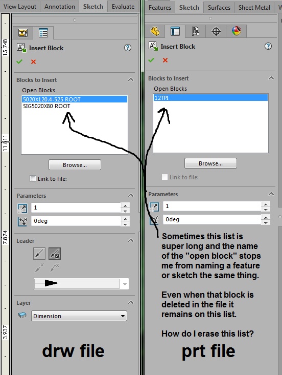

When you select Insert Block it gives you a list of "Blocks to Insert" and has all the "Open Blocks" listed... how do I clear this list?

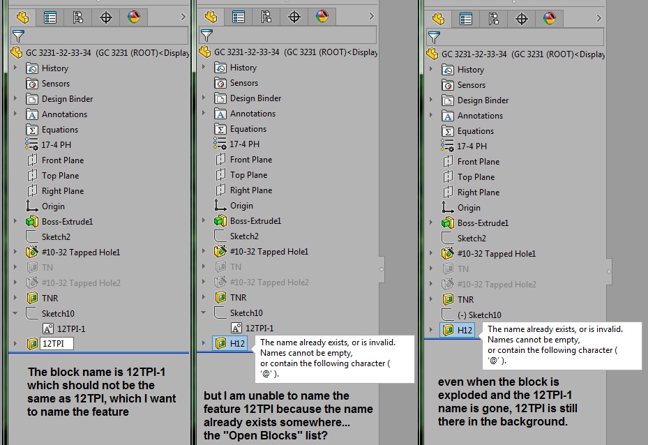

Sometimes this list is super long and the name of the "open block" will interfere with naming a feature or sketch.
Even when the block is deleted/exploded in the file the name remains on this list.
So how do I erase or clear the "Open Blocks" list in the Insert Block function?

You need to delete the block in drawing to clear the list
For the part, you need to Explode the blocks in the sketch, save the part,  re-open it, to clear the list.
