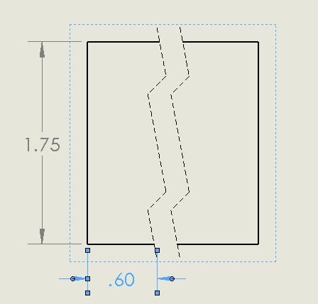

How to Check if the Dimension is Linked with Breakline of the Drawing?
I have a UseCase To check If The Display Dimension is Linked with Breakline in code :
Drawing :
UseCase :
  1. I have a code that Iterates through the Drawing, Sheets , Views and Dimensions.
  2. I need to get the list of Dimensions in a View with a check if the Given Dimensions are Linked with Breakline.
  3. I am trying to filter out dimension which are linked with the Drawing View Breaklines from other dimension in the View.
  4. I will be manipulating these dimensions, in later as required.
THINGS Tried :
  1. I tried using Annotations-GetAttachedEntityTypes()
  2. Tried Comparing with swSelectType_e SolidWorks.Interop.swconst.swSelectType_e.swSelBREAKLINES ENUM
  3. These ENUM return : swSelEDGES and swSketchSegment (corresponding to breakline)
  4. But, None of Attached Entities Match with Breakline ENUM.
Is there is method by which I can check if the Display Dimension is linked with Breakline with C# Code ?
OR
Is there any way I can determine if the source of Above SketchSegment is BreakLine ?
(This would confirm that the Dimension would be the Breakline Dimension)
