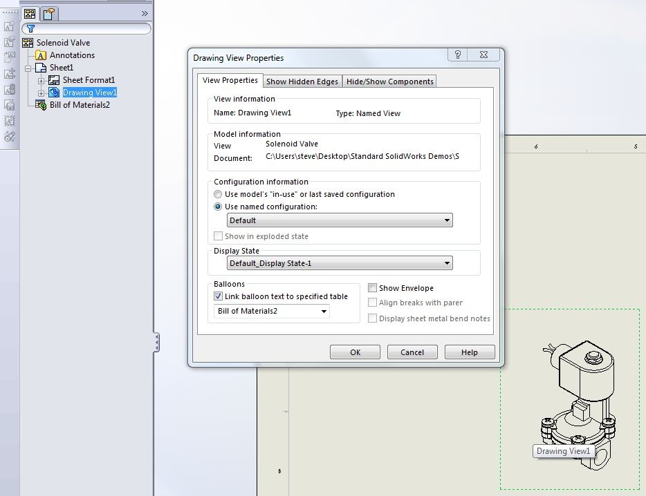

Right click in and select Properties. This will bring up the Drawing View Properties dialog. At the bottom of the dialog you will see a Balloons section with a pull down list of Bill of Materials1, Bill of Materials2, etc. These will coordinate with Bill Materials1, Bill of Materials2 listed in the FeatureTree. See my attached screen shot.

Right , but I have different assemblies on that drw ,
from which view this BOM or that BOM was created by origin ,
if I was inserting BOM I chose some view ( I want program let me know that view)
I hope it is understable ,

When you first insert a BOM, you have to select a drawing view to attach it to. That creates the link. If you open a drawing where you don't know which views are attached to which BOMs, then you have to look at the Drawing View properties as I explained in my previous post. I'm not aware of any other indicators to know which views are associated with BOMs.
