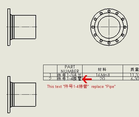

How to change the note in BomTalbe?
D
Debug.print  Bottom Code , Result
    PART NUMBER 材料    质量    QTY.
1   件号1-3法兰 16MnII  11.33   1
2   件号1-4接管 20  6.30    1
My question
How to change "件号1-4接管" to "Pipe" ("件号1-4接管" replace "Pipe")
Programe Code

SolidworksApi macros
Answers 2
YN
YN 2012-02-26 Best Answer
In this tip, https://forum.solidworks.com/message/110919#110919
like code is

My question
GetType--14 ---------GetName--细节项目104 -----------What mean for "细节项目104"
YN
YN 2012-02-27
'Get Table Annotation and Contents Example (VB)

debug.print result
File = F:\BE(J)S\BES500-2.5-55-6/25-2I\件号1管箱.SLDDRW
  件号1管箱
    细节项目104 <2>
      [6,,,1,Q345R,,49.14,]
      [5,,,2,20,4.58,9.16,]
      [4,HG/T20592-2009, 法兰 WN250-25(B) RF,2,16MnII,11.33,22.66,]
      [3,,,1,Q345R,,73.85,]
      [2,,,1,Q345R,,200.58,]
      [1,,,1,Q345R,,118.72,]
      [序号,标 准 号,名        称, 数量,材    料,质量(单),质量(合),备 注]
  件号1管箱左
  件号1管箱右
