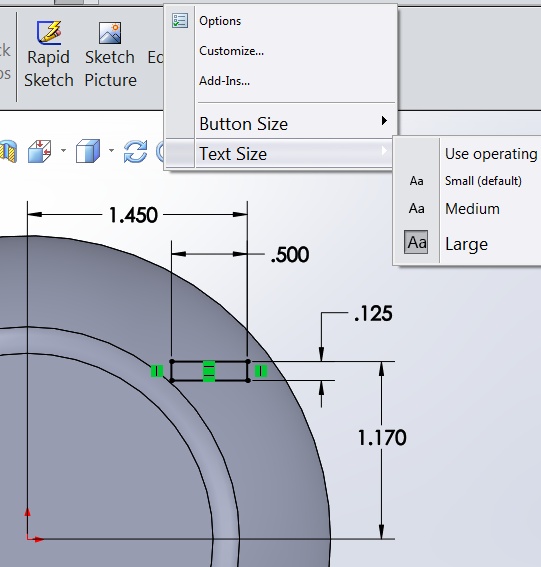

Is there a way to change the sketch dimension text height?
I am teaching in a very large classroom this year and I noticed that it is hard to see the dimensions from the back of the room.
I figured out how to change the size of the buttons and text, but not the sketch dimension text ht.
I thought for sure I had seen a setting for this before, in fact, I know I have opened files with very large sketch dimension text.

Of course, right after I post I find it.
I guess I was expecting this to be only for slddrw.
comment imagecomment image
