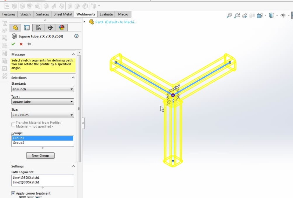

How to change 3 joint corner?
I'm trying to make the joint in the solid model look like the joint in the sample picture I provided. The below is the best I could do but it still looks off. Any ideas on how to make this type of joint?

Create the joint in single feature and change joint trim order to get desired results
OR may be like this.

If you are going for the first one I hope you have a tube laser.

Will the second one be considered like the picture by a manufacturer? Because that's the one I can do.
When I attempt the first option, I couldn't even select the bottom joint, so I could only miter the top 2 joints. Plus, I couldn't find the box to change the trim order.

We definitely don't have that.

Both can be accepted depending on requirements and capabilities. Checked attached video to see as how to make both.
