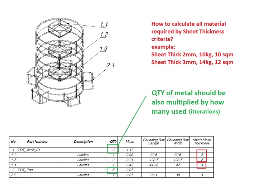

Hello, how to calculate whole amount of material in Solidworks from BOM? For example, you can easily get overall length of weldment. But what about Sheet metal?

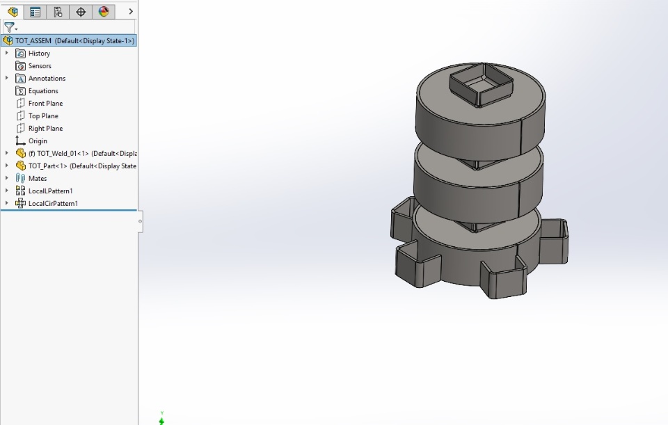

In example attached, I used one part as weldment, with different material thicknesses, and other is single sheet part.
What is the most common method to get overall Material amount? example: sqm, weight and etc.

Hello, Soren, thank you for your answer.
The lines are not in one line, it will be difficult to write exact formula, for every case.
