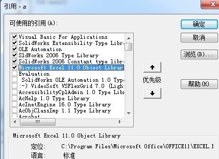

How to calculate string ("1+2") with API?
In API of Solidworks, with excel function. Calculate Str.
Private Sub del()
   Dim Str
      Str = "1 + 2"
   Dim Xls As Excel.Application
      Set Xls = GetObject(, "Excel.Application")
      Debug.Print Xls.Evaluate(Str)
      Stop
   Dim SwApp As SldWorks.SldWorks
End Sub
Help me. How to calculate the string of arithmetic.
SolidworksApi macros
