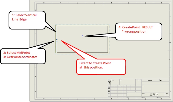

How to calculate CreatePoint in drawing file via midpoint ?
I can't create point at the MidPoint position.
How can I draw Point at the correct position ?
I got EdgePoint datum and got xyz by using EdgePoint.GetPointCoordinates method.
I run CreatePoint method, but its position is wrong.
    ' Select MidPoint
    swModel.SelectMidpoint
    ' Get selected EDGE
    Dim edgep As SldWorks.EdgePoint
    Set edgep = swSelMgr.GetSelectedObject6(2, -1)  ' first:Edge, second:EdgePoint(PointRef)
    Dim swEdgePt As EdgePoint
    Set swEdgePt = edgep
   ' Get MidPoint Coordinates
    Dim mx As Double
    Dim my As Double
    Dim mz As Double
    Call swEdgePt.GetPointCoordinates(mx, my, mz)
    Dim mPt(0 To 2) As Double
    mPt(0) = mx
    mPt(1) = my
    mPt(2) = mz
   ' Create Point at the midpoint position
    ' But its position is wrong.
    Dim skPt As SketchPoint
    Set skPt = swModel.SketchManager.CreatePoint(mPt(0), mPt(1), mPt(2))

NS
NS 2017-08-08
Hi Manikandan, thank you so much.
Your code worked fine.
But mycode fails at
swmodel.SketchManager.CreatePoint x, y, z
' ----- YOUR CODE --------------------------------------------
boolstatus = swmodel.Extension.SelectByRay(4.02766871648805E-02, 8.54934081756364E-02, 4.99999999999545E-03, 0, 0, -1, 1.41495828362914E-03, 1, False, 0, 0)
swmodel.SelectMidpoint
Set swedgept = swSelMgr.GetSelectedObject6(1, -1)
' ----- MY CODE   (run after edge is selected.) ----------
Set swedgept = swSelMgr.GetSelectedObject6(2, -1)
x, y, z values are same. (your code VS my code)
I got correct position, so I think that my CreatePoint code is wrong.
I'm confused...

NS
NS 2017-08-08
Hi, Manikandan
I found the condition that  [my code & your code] fails.
1) When sheet is selected  (therefore no view is selected), it works fine!
2) When one view is selected, it fails.
In case of 1)  we must consider view offset.
   ( your code or my code)
    x = swViewMidPt.ArrayData(0)
    y = swViewMidPt.ArrayData(1)
    z = swViewMidPt.ArrayData(2)
    ' Get View Offset
    Dim vViewOffset As Variant
    vViewOffset = swview.Position
    Dim offsetX As Double
    Dim offsetY As Double
    offsetX = vViewOffset(0)
    offsetY = vViewOffset(1)
    x = x - offsetX      ' subtract view offset X
    y = y - offsetY      ' subtract view offset Y
    ' CreatePoint in drawing
Thank you for your help.
I found a solution.
Thank you, Manikandan
