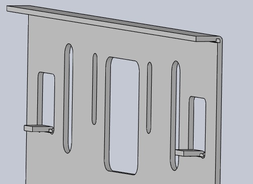

In many cases (like the attached part) we would not be able to make the bends tight enough (even with a break) without fracturing the Aluminum on the bend unless we thin the material at the bend line.

We typically will create the part using a sheet metal thickness equal to the kerf thickness and then thicken the areas outside the kerf by adding a boss extrude.
This will achieve the desired final part but once a boss extrude is added to a surface it makes SWX treat this as a solid part and no longer as sheet metal (it suppresses the ability to get the flat pattern).
I have tried to also thicken the part before bending but the boss extrude on the bent edge will not remain attach (only the underlying sheet metal thickness will bend).
I have tried to model this as a solid body part and extrude the unwanted areas - but again this is now a part rather than sheet metal.
I need to show the flat pattern for machining and the bent part for final fabrication.
