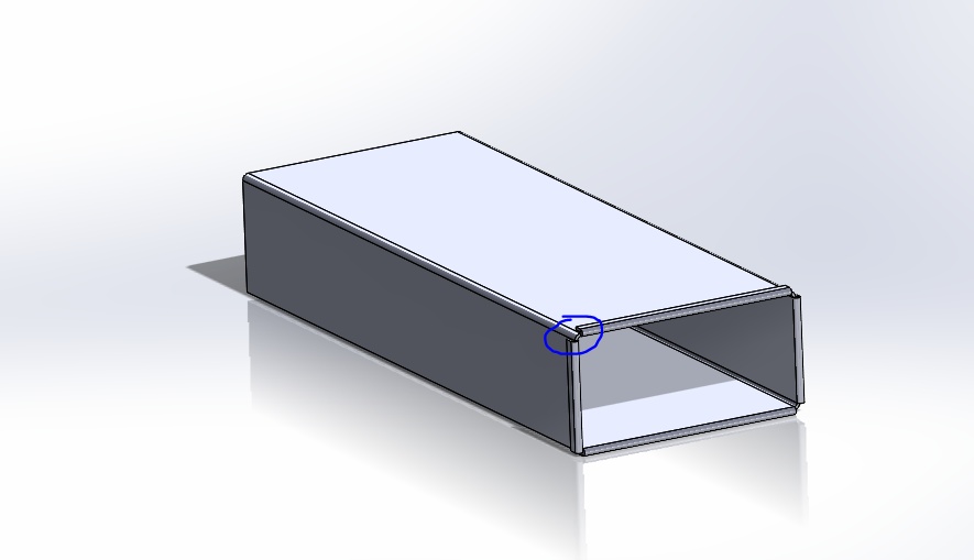

How to bend a hem in a sheet metal part?
Hello all
I am trying to bend the hem of a sheet metal part, but not able to do it. Attached is the picture for you to understand what I am talking about. Is there any possible way to bend a hem and get a flat pattern without any error?
Thank you all for your time.

Simple answer is NO, you can't do that.
You may want to try creating your hem using swept flange option (if that works). Then flat pattern should not be an issue.

Hello Deepak
I have used the swept flange option and it works. But, flat pattern doesn't work saying they are features that cannot be bent.
I think its not possible in solidworks to achieve this.
But, I have seen a fabricated model of a cage with hem bent at the corners as well unlike as shown in the picture. So, it should be possible. May be it was not modelled in SolidWorks before being fabricated.
Thank you for your time.

Siva -
For the hem to go around the corner the material would have to be bent perpendicular to the long axis to form the hem and then bent parallel to the long axis to form the tube.
Solidworks sheetmetal will not bend the same material in 2 perpendicular directions because it is much more complicated to predict the flat pattern required.

Can you attach your file made using swept flange??

Hello Chris
I have tried that as well. First hem on plain sheet and then tried to bend it 90 degrees. Unfortunately to my dismay, the bend doesnt work.

Sure Deepak. I have attached the file for your reference.
DG
DG 2013-10-25
As said earlier you need to use swept flange option from sheet metal and not sweep feature: Swept_Flanges
Can you give it a try.
P.S. I added few screen shots of how the tool worked nicely for me. Will add the sample file later if you need.
SP
SP 2013-10-25
Thank you. Thats wonderful. I guess you din't make a base flange first. I first made a base flange and used the swept flange ( the attached file contains the boss sweep, my bad).
I made the base flange and then bent it to form a box and then made a small sketch profile of a hem and finally tried to use swept flange for the entire rectangular path.Then it failed at the corners.
But, what you have done is use the swept flange directly without any baseflange. That's amazing, I almost thought its impossible in SolidWorks to get the flat pattern of a bent hem. But now I am convinced otherwise.
Thank you very much Deepak. You have always been a great help.
