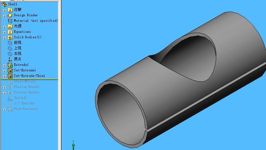

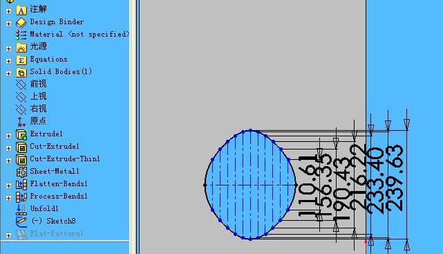

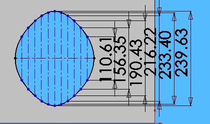

how to autodimension all sketches in Sheet metal
Hope, with API, drawing dimension.
Use API help example → don't drawing dimension.
Autodimension All Sketches Example (VB)
This example shows how to autodimension all sketches in a part.
