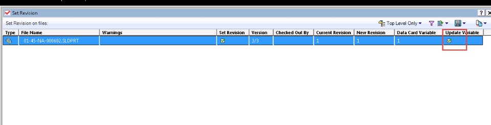

- Revisions on transitions are getting changed properly in back end
- User always need to fire 'Modify>>Set revision' command manually after transition to update data card variable(revision) to match set revision number
Query:
- how to avoid this manual activity of 'update data card variable'
- How one can set data card variable (revision) on transition action to match revision number counter set for particular state.
