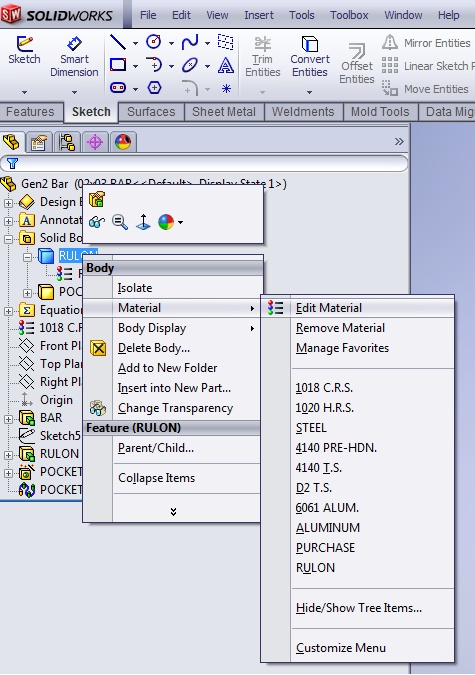

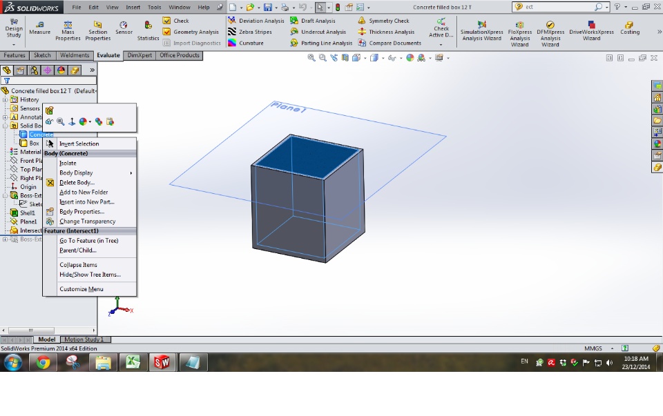

I'm looking for a way to apply different materials to bodies in a single part, i have seen this: . Now the problem is that when I right click the different parts it wont show "material", as can be seen in the attachment...?  Below is an example of how it should be:

you could not assign body material while some features is in rollback state :-
so you have to drag the roller to the end of features tree, if some thier is some features you don't need , just suppress it (right click, suppress)

Try moving your Rollback Bar all the way to the bottom of the tree.  I find I can only apply different materials to multi-bodies with the Rollback Bar at the bottom (not sure if it's a bug or intended behavior).

Thanks guys, it worked !
