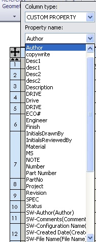

How to alter "Column Type: CUSTOM PROPERTY" dropdown
1. Create an assembly
2. Insert, Table, Bill of Materials...
3. Table Template: bom-standard
4. Right-click "A" or "B" or "C" etc.
5. Insert Column (Left or Right)
At this point the little window with "Column Type:" and "Property Name:" appears.  How do I alter the values in this dropdown.  I've already changed the "properties.txt" within *\\SolidWorks 2010\\lang\\english and that now appears in file properties, but there seems to be no way to change the BOM properties.
TIA  -  Abraham

That dropdown will list all custom properties available in any part or subassembly listed in the BOM.  Just add the desired custom property to some part in the assembly and it should show up there.  You may have to make sure the assembly is not lightweight or something.
SF
SF 2010-01-12
I tried that, it didn't add to the list.
JB
JB 2010-01-12
Works for me.  Did you forget to give your new property a value?  If so, it won't actually add the property.
