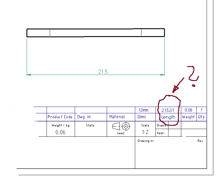

I'm having a simple pipe and it has been done by Routing so the length comes automatic to the BOM.
Is it possible to adjust precision so that it would give me 215 instead of 215.01 ?
Routing creates an assembly where this pipe is as a part. I adjusted part properties but no effect. Can't find property from part that is listed in the BOM (PRP:"SWPipeLength") so can't adjust it. Where is it and how to set precision for it?
Tried also to set precision for BOM -column, but no effect.

Did you change your Tools/Options/Units ???
TS
TS 2021-04-09
Yes, I tried it both a part file and also in assembly file, but it had no effect in BOM
BUT HEY! BINGO !!
I changed it in a drawing file Options .... and ... now it works!
THANK YOU,
DP
DP 2021-04-09
Yes, SW 2018 made this change.  Now the drawing units and precision controls things that are on the drawing instead of the part/assembly (like it was before)
