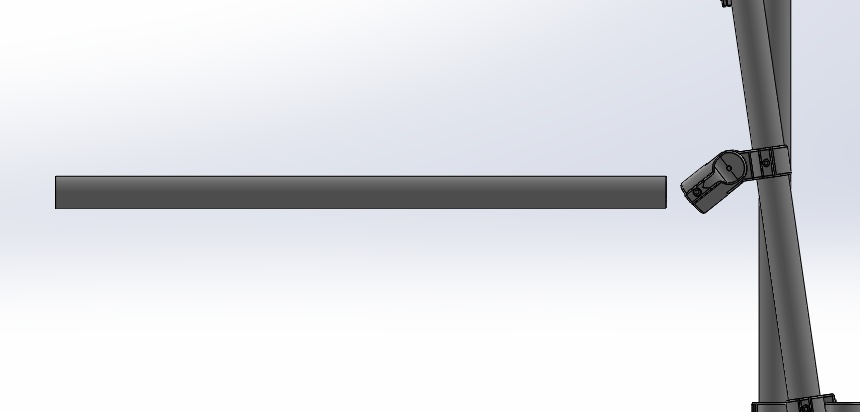

I have a horizontal pipe and want to mate it with the "adjustable angle" tee to the right while keeping the pipe horizontal. How do I adjust the angle of the part so that the pipe stays horizontal?

Mate the Tee to the pipe and add parallel, angle, etc. mate to pipe to keep it horizontal. And keep the tee rotating free while it is mated with the pipe.

      Thank you very much. However, it seems like I am unable to access the parallel mate (I have attached a screenshot below). How should I proceed? Thank you again

Also, it still does not let me adjust the angle of the tee. How does this work?

If the adjustable angle is an assembly, you can just make it "flexible" in the top level assembly, (you will want to suppress any rotational mates at the sub-assembly level.)
If the adjustable angle is a part, you will need to edit the part to get the angle to match that of the horizontal pipe (this will effect any assemblies that use this particular part.)
Hopefully it is an assembly - it makes things like this a lot easier.

To make your tubing horizontal, I would recommend mating one of the planes of the part parallel to a plane in the assembly.
(Presumably the "top" plane in the assembly.)
Mating with planes is a much more robust method of assembly mating.
With regard to the tee, I believe that you are actually going to need to edit the part to change it to the angle that you need.
(You may want to make a copy of the part before doing this so that you don't cause issues if the part is used elsewhere.)
If the tee was an assembly, you would be able to rotate it into position, but it is a single part, so there is no movement.
(You might be able to make it a multi-body part to get the desired results.)

I just downloaded the file for the tee - you are in luck, they did it as a multi-body!
Open up the part, go to "Sketch10" - this sets the angle of the tee.
(You will need to calculate the angle in the assembly, and then get into the part and make the change.)
It works pretty well, I've moved it around quite a bit!
todd

In addition to what Todd suggests, if the Tee is a multi-bodied part, use the Move/Copy... feature.  Use the Rotate option and make a configurations for as many angles as you need. I've done that with parts like that in the past.  I looked but couldn't find an example I'd saved anywhere.
If you want to be able to dynamically move the part in the assembly you will probably need to convert the part (if it is multi-bodied) to an assembly with the Save Bodies... feature.
