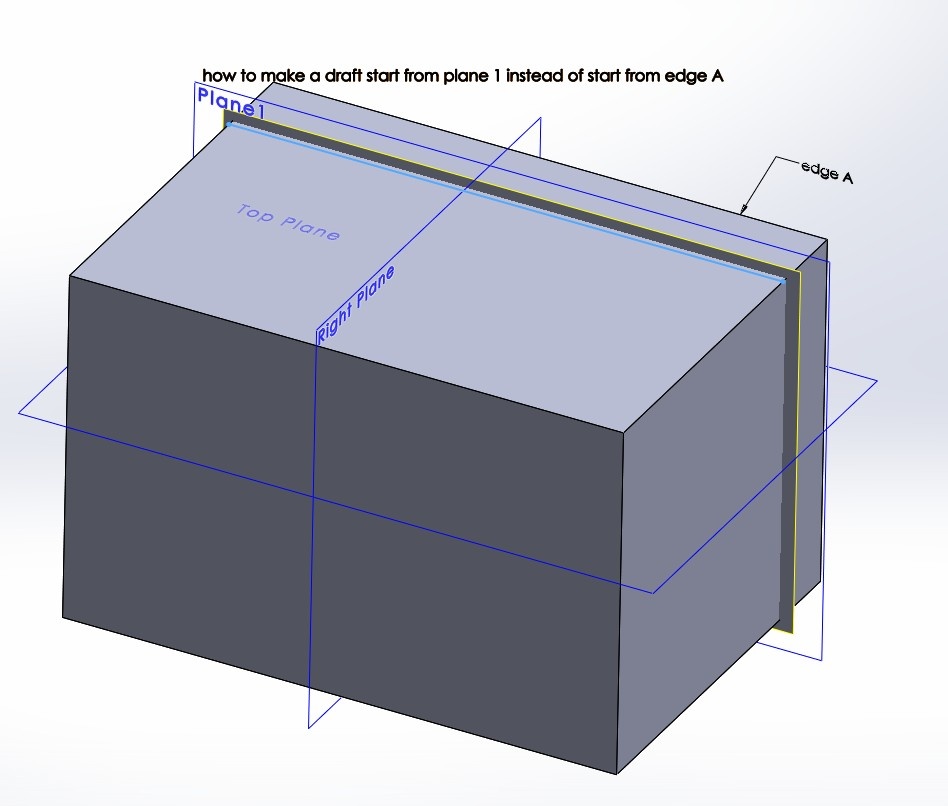

You can use rotate face if you don't want to start from edge, you can use split line
MP
MP2014-11-06
Not sure if this is what you are looking for but you can create a split line on the surface you want to draft at Plane 1 and then apply draft to that surface.
Why can't you simply use the chamfer command?
