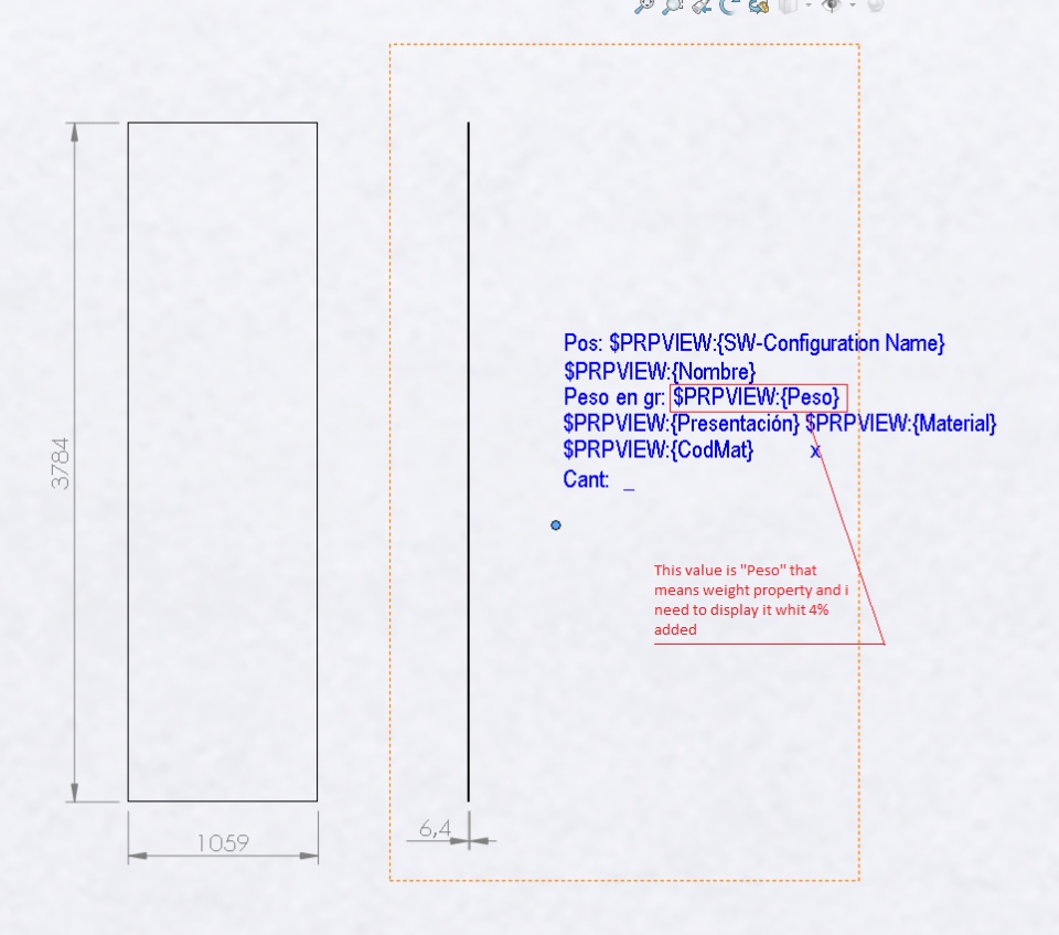

Please. How to add an equation to a note?
I mean.. I've make a block note with a weight PDM property vinculated, and I need to increase this value over 4%. The only way I think it is possible is to writing a kind of equation (In the note) like   \\\$PRPVIEW:{Weight}*0.04+\\\$PRPVIEW:{Weight} but it doesn't work for me please somebody helpme.

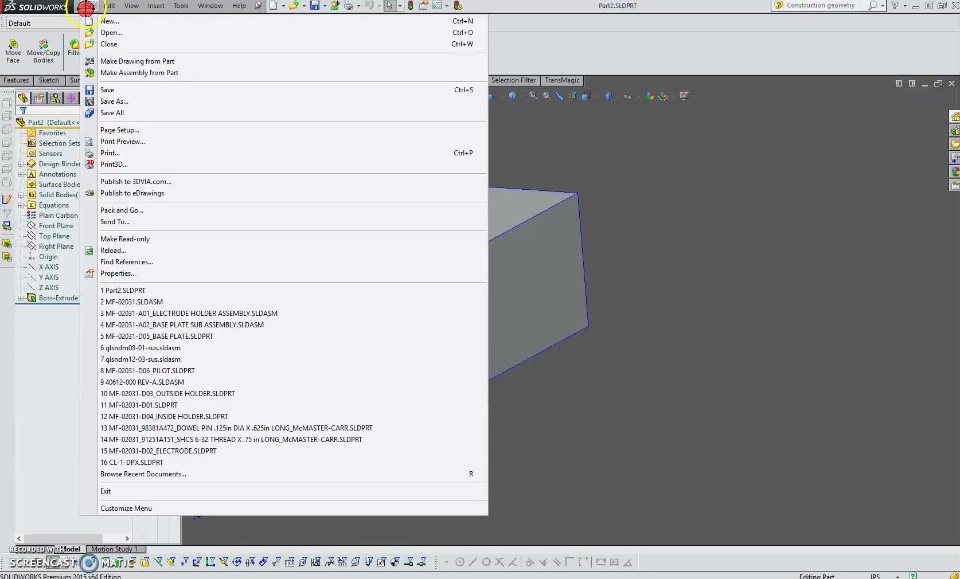

DP 2017-10-20 Best Answer
You can do this in a global variable at your part level.  Then link your global variable to a custom property.
Then use that custom property in your drawing in a note.
See attached video:
VU
VU 2017-10-20
1. Link SW-Mass property calculated by SW to Global Variable and multiply by 1.04
Now you can link GV "mass" to custom property "Weight" and link custom property "Weight" to annotation:
