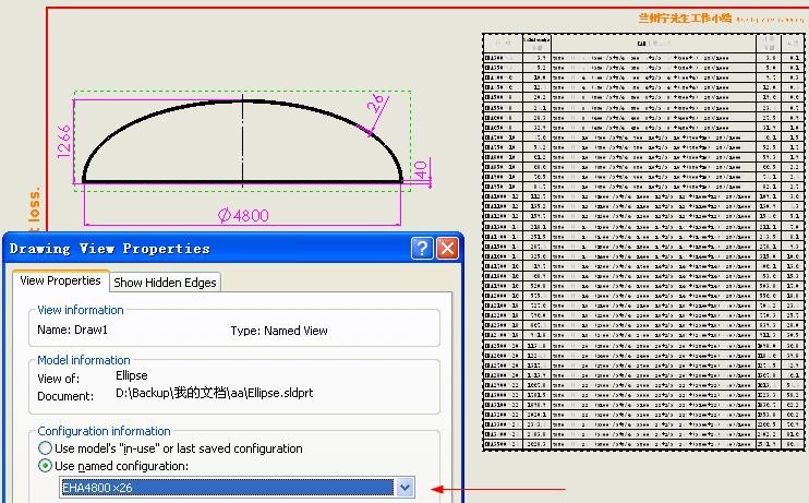

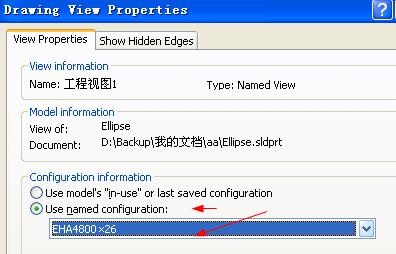

Hope activate use named configuration with API.
Use this method: http://help.solidworks.com/2010/English/api/sldworksapi/solidworks.interop.sldworks~solidworks.interop.sldworks.iview~referencedconfiguration.html
Here is teh example: http://help.solidworks.com/2010/English/api/sldworksapi/Get_Configurations_Referenced_in_View_Example_VB.htm
Thank you reply, often using the GetReferencedModelName statement. But not with the ReferencedConfiguration statement.
