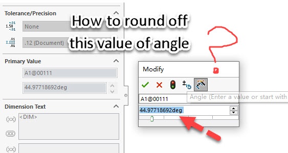

Enter the Angle dimension value, need to convert the value to radians, after updating the dimension, but when the Angle is displayed in the dimension, it cannot be integer. You guys may check the screen capture to know the detail. thank you
Use SetUserValueIn2 and just set it to 45 degrees. https://help.solidworks.com/2017/english/api/sldworksapi/SolidWorks.Interop.sldworks~SolidWorks.Interop.sldworks.IDimension~SetUserValueIn2.html
