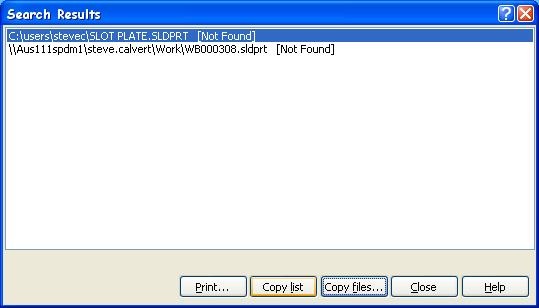

Paul, when the assembly opens and nothing is there, do a File -> Find References.  Now do a screen shot of that window and show it to us.  Are the files in the location the assembly is looking for?  Maybe someone has moved them, it sounded if though you're smart enough to save them.  Just a thought.

Paul, please do a screen shot of the File -> Find references as I asked for earlier.
