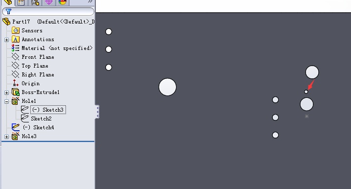

I want to write a small programme that can automatically draws the part. The problem now is that I don't know how to use Holewizard to add several holes at one time.
I try to preselect a point on the face, then use holewizard to create a hole, then edit the sketch and add the rest of the hole.(I wonder if there is a better way to do this.)
Suppose I have a part file below.The arrow is the only point in the Sketch3.
The following is my code (I use Vs2008 C++ to develop sw2012):

| hres = swDocExt->SelectByID2(L"Sketch3",L"SKETCH",0.0,0.0,0.0,VARIANT_FALSE,0,NULL,swSelectOptionDefault,&bRetbool); // This doesn't work. Cause it's invisible? Or I made other mistakes? Even if I specify the type argument as "SKETCH".,finally the Origin Point is selected. | ||
swDoc->EditSketch(); | ||
| //hres = swDocExt->SelectByID2(L"Point1@Sketch3",L"EXTSKETCHPOINT",1.13,1.25,0.0,VARIANT_FALSE,0,NULL,swSelectOptionDefault,&bRetbool); | ||
| //This sentence may work if I manually show the hiding Sketch3. But I don't think it's a good way. | ||
