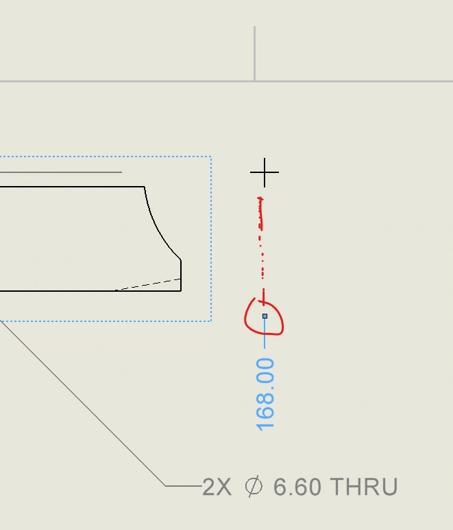

We have recently "upgraded" to SW 2024 SP3. several people have noticed that they cannot select dimension end points anymore. the attached picture is an example. the dimension end point is located a distance from the center mark. the user would like to have the end point located closer to the center mark. previously you could selected the blue square "dot" circled in red and place it where you would like. now you can't seem to select that point.

why only update to SP3 and not SP5, also why did you put "upgraded" in quotes suggesting something odd.
I'm not sure what exactly you are trying to do, why are you trying to move a single point in the drawing environment? ARe you trying to measure from the center mark to the horizontal edge at the bottom of the drawing view?

See this "enhancement" description. It removed the ability to move the end points of dimension extension lines.  Many people, including me, have complained about it, but as far as I know it hasn't been fixed yet.

Two avenues:
  1. Delete the dims and RC>Add to Ord Dim
  2. Turn extended lines back on for the center mark
I see your vertical is also gapped, but don't delete the mark as this won't also delete both associated dims in one whack, it will instead worsen the gap issue for both dims.

with the way the program started working it is very picky about manual dimensions and those extension lines.  You can try to reattach to the point you want it to be and see if that helps.  I have been getting back to inserting dimensions from the model when possible and then you can drag extension lines for those dims.

This issue seems to be fixed in SW2024SP5.0 so I would consider upgrading to this version.
