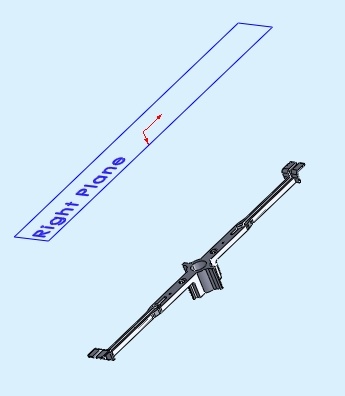

I have a model that was sent to me and the origin is not close to the part and one of the planes is not either. How do you move the origin and plane to a position to where I can use it in an assembly?

The origin and main reference planes cannot be moved.
Use the Move/Copy Bodies tool to move the solid to the required location
It looks to me like this part was created on the surface of another part in an assembly and therefore adopted its planes and origin.

I just like my planes to be aligned with the origin. It just looks odd having one plane way out in space instead of on teh face of my part.
