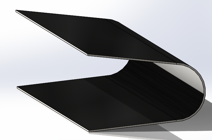

Dimensioning it nicely and using Instant-3D could be an option.
Use the attached part instead. Modify the dimensions as you see fit then you can simulate the movement by playing with the angle value using Instant3D.

Yeah that makes it move up and down but not really useful in an assembly or for analysis of forces on the part. Thanks though.

I agree with you. Not the way you dimensioned it, for sure.
You need to preserve the length of the spring in your dimension scheme.

What do you mean?

Use this attachment instead. Just vary the distance between the ends.
Also watch this video:

Do you happen to have SolidWorks Premium or the Simulation product?

I have solidworks premium

Then just do a simulation study using large displacements and get both the force and the animation.

I am not sure how to do that on Solidworks. Any pointers?
